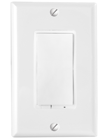

Inovelli Dimmer Switch - NZW31-S - Spec Sheet
Spec Sheet | Dimmer (Gen 1) | NZW31
The NZW31 Inovelli Dimmer Switch is a Z-Wave enabled smart switch that works with many different hubs and gateways and allows remote control from anywhere in the world.
Overview
Make: Inovelli
Model #: NZW31
Generation: First (Predecessor To: Second Generation)
Years Produced: December 2017 - December 2018
Status: Discontinued
