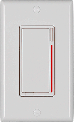

If the LED Bar (B) turns RED, the device is not within range and needs to be moved
NOTE: Sometimes the LED bar lights up RED and the switch is within range. While rare, this has been reported on some of the switches. If you're confident your switch is within range, please proceed to the, "Pairing (Inclusion) Steps" below.

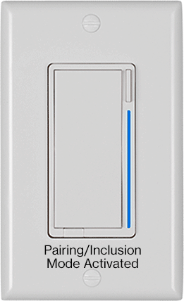

On your Inovelli switch, press the Config Button (A) 3x rapidly and the LED Bar (B) will pulse BLUE (if it doesn't, please tap the config button faster)
If successful, your Inovelli switch LED Bar (B) will turn GREEN (if unsuccessful, the LED Bar will turn RED)

On your Inovelli Switch, press the config button 3x rapidly (the LED bar should pulse blue)
If the exclusion was successful, your Inovelli switch LED bar should turn from pulsing blue to GREEN
