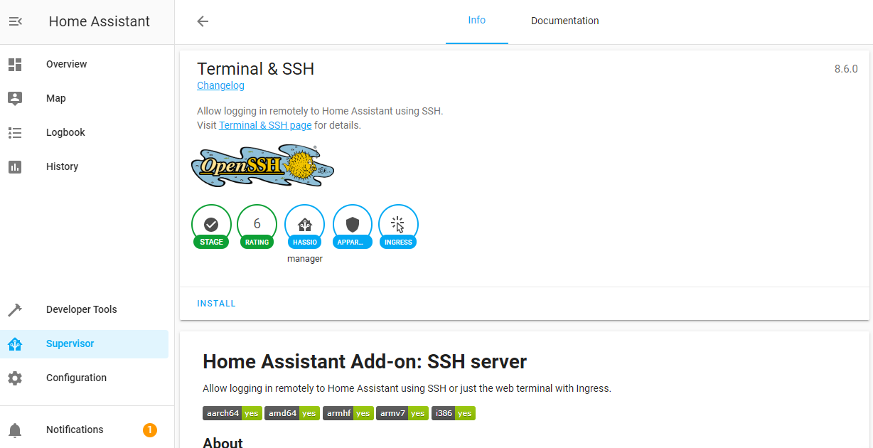

Setting Up SSH Terminal Add-On
  1. Click on the "Supervisor" link in the left hand "sidebar".
  2. Click on the "Add-on store" tab at the top.
  3. Click on the "Search" text field and type ssh & hit Enter. You should see the "Terminal & SSH" add-on appear.
  4. Now click on the add-on and hit "Install".
  5. Once the install is finished, click on "START" and "Show in sidebar".
  6. You are done with this section!

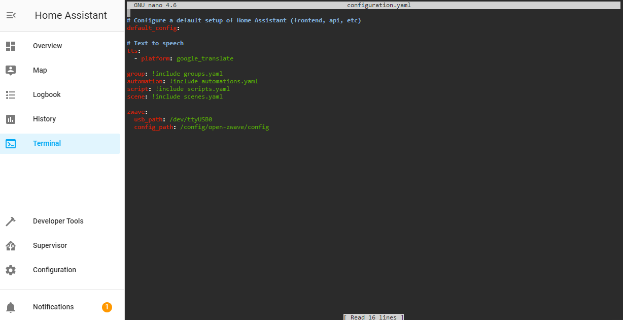

Edit the Home Assistant Config File
  1. Open the configuration file for editing with:
    nano configuration.yaml
  2. Add the following configuration into your configuration file:
    zwave:
      usb_path: /dev/ttyUSB0
      config_path: /config/open-zwave/config
The path of your USB Z-Wave device may be different than /dev/ttyUSB0. If this is the case, please make sure you put the correct location here.

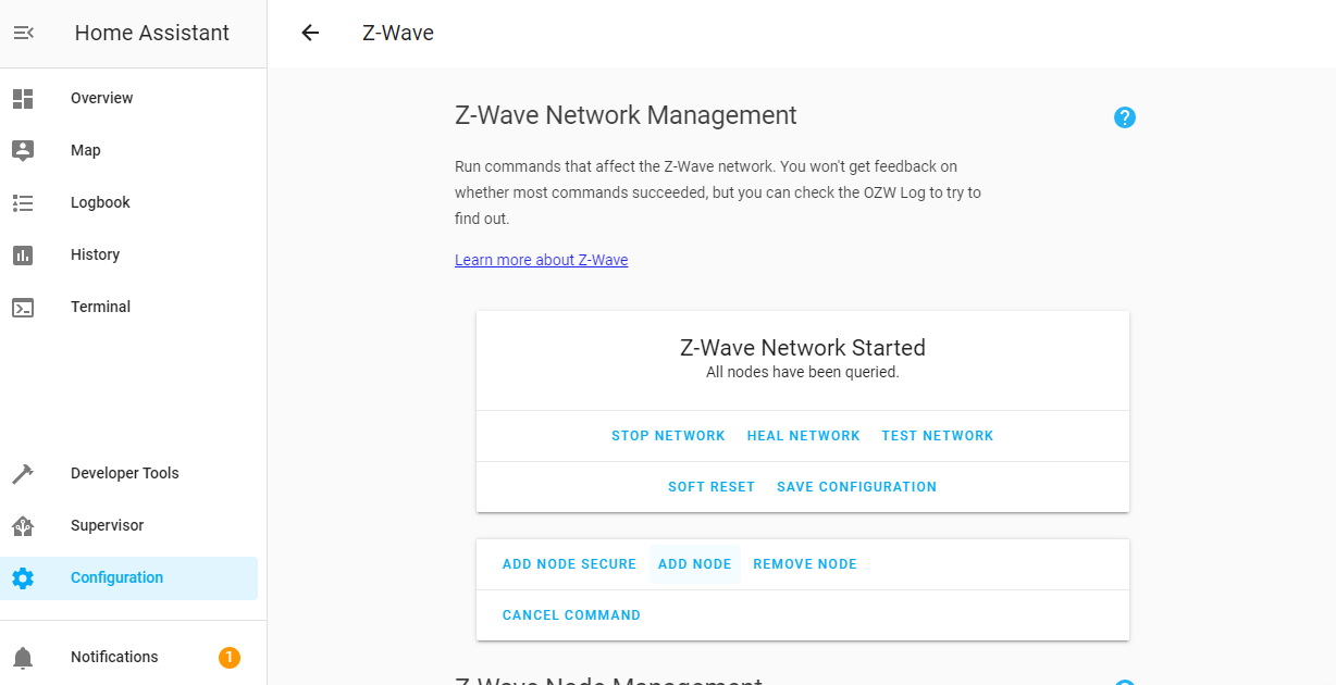

Include The Device
Now that the config files are in place, we can initiate the inclusion in Home Assistant.
  1. First, navigate to your Home Assistant home page and click on "Configuration".
  2. Next, scroll down to the bottom and click on "Z-Wave". This will bring you to the Z-wave management screen.
  3. From here you need to click on either "ADD NODE SECURE" or "ADD NODE". In some networks adding the device secure may impact network performance. If you are having issues, you may want to try to just "ADD NODE".
  4. At this point you can press the button on the back one time. Wait for a minute or so and the device should show up in your node list.
  5. From here you can edit the configuration options or go back to the "Overview" page to view the device in action.
