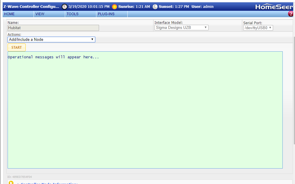

  2. Next, expand your Z-Wave interface and choose "Actions" > "Add/Include a Node" and press "Start"
  3. At this point, press the button on the device once and it should put it into inclusion mode.

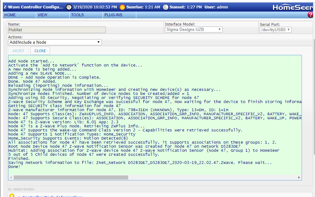

  4. Messages should appear showing the inclusion was successful!

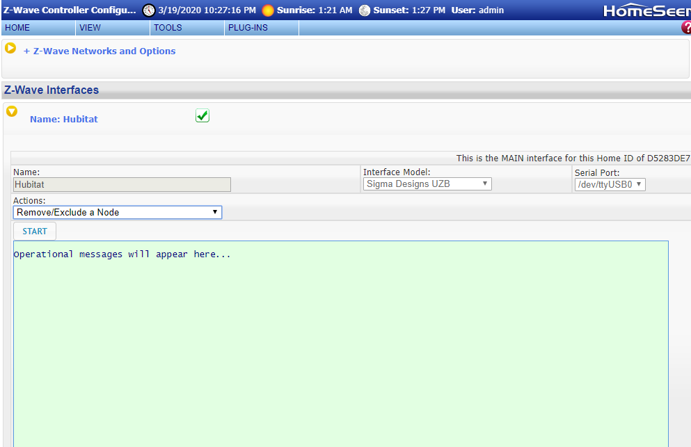

If the inclusion does not seem to be working, you may want to try an exclusion first. To exclude the device the steps are the same except where you get to the "Action" input you select "Remove/Exclude a Node". After the exclusion starts press the button on the device once. You should see some status text displaying that the process has completed and then you can continue with the inclusion.
