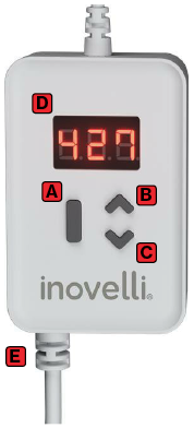

  4. At this point you can press the config button (A) 3 times to put the device into inclusion mode.
  5. From here you can edit the configuration options or go back to the "Overview" page to view the device in action.

If for some reason the switch is not including, first make sure you are within range. Next, try an exclusion of the device before trying an inclusion. For an exclusion, the steps are the same as above except that on the Z-wave management page, you click on "Remove Node" instead of adding it. After clicking on "Remove Node" press the config button (A) 3 times. After the exclusion is complete, you can proceed with the inclusion as stated in these instructions.
