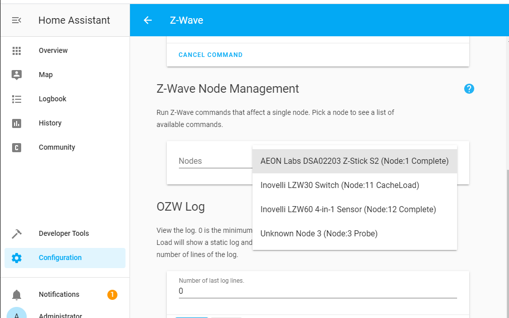

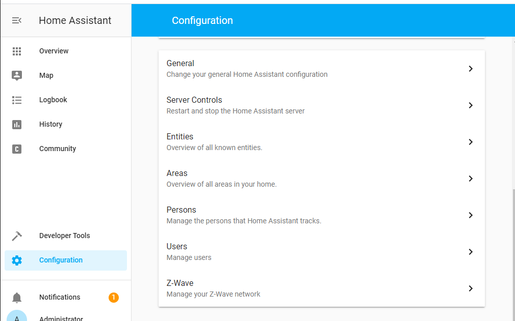

  1. First, navigate to your Home Assistant home page and click on "Configuration".
  2. Next, scroll down to the bottom and click on "Z-Wave". This will bring you to the Z-wave management screen.
  3. From here you need to click on either "ADD NODE SECURE" or "ADD NODE". In some networks adding the device secure may impact network performance. If you are having issues, you may want to try to just "ADD NODE".
  4. At this point you can turn the bulb off and then on again. Wait for a minute or so and the device should show up in your node list.

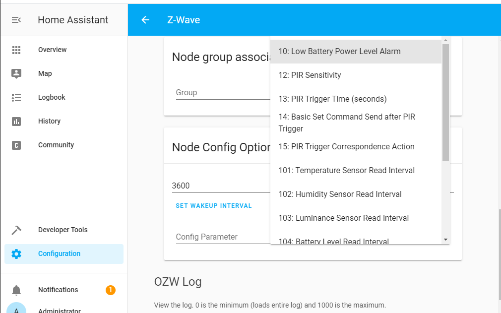

  5. From here you can edit the configuration options or go back to the "Overview" page to view the device in action.
