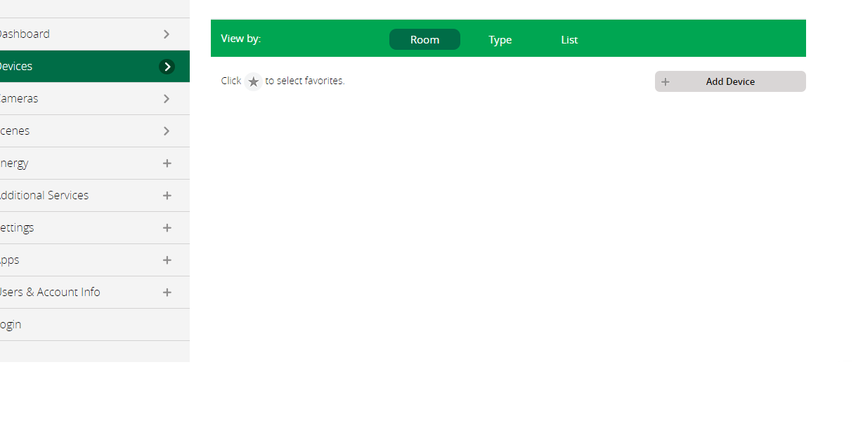

  1. Click on "Devices" and then "+ Add Device" to start the process of adding your device to the network.

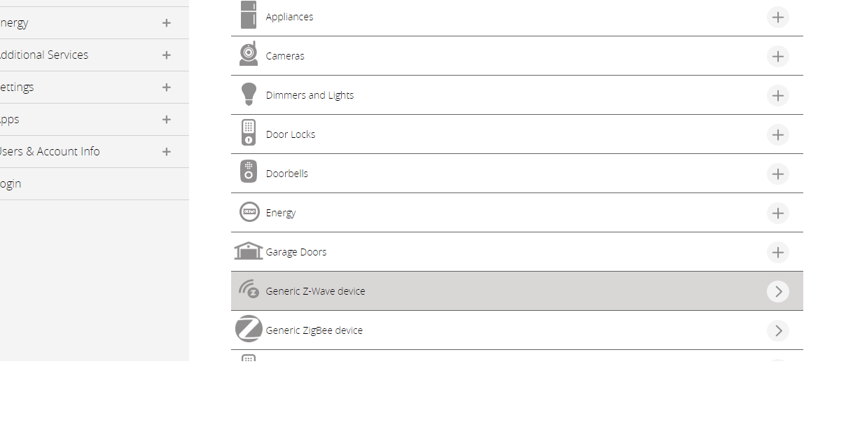

  2. Scroll down and choose "Generic Z-Wave device".

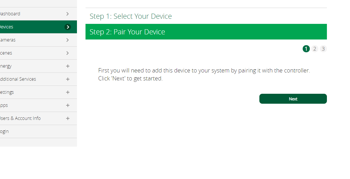

  3. Click through the prompts until you get to the screen that says "Follow the inclusion process as described in the users manual".

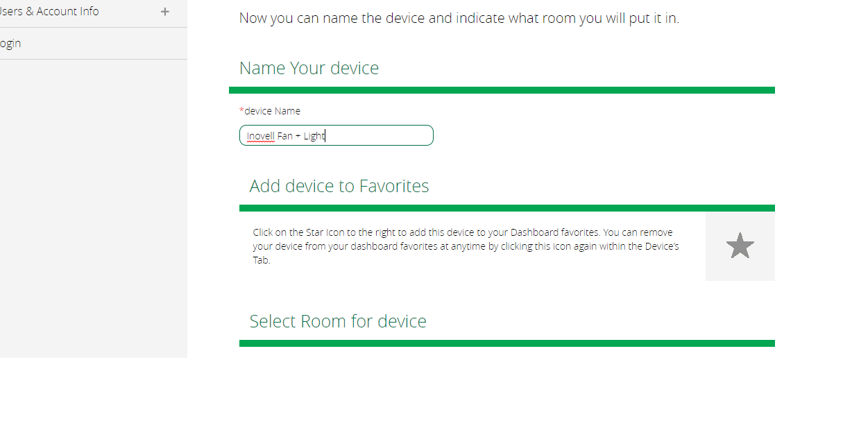

  5. Choose a name for your device and a room if you desire. Click next to proceed.

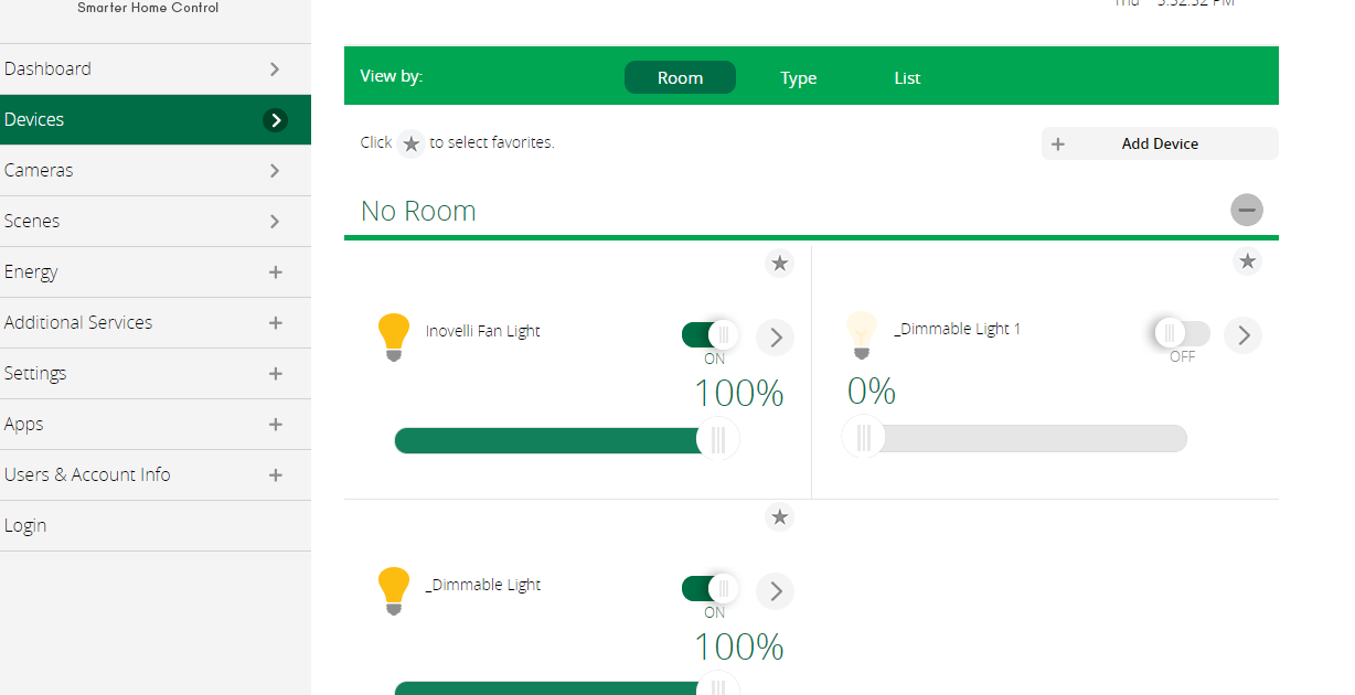

  6. Finally, the device will show up as 3 separate devices in your device list. The devices that start with a "_" are the separate channels you can control. One represents the fan and the other represents the light. The main device (without a "_") is the root device and it controls both channels at the same time.

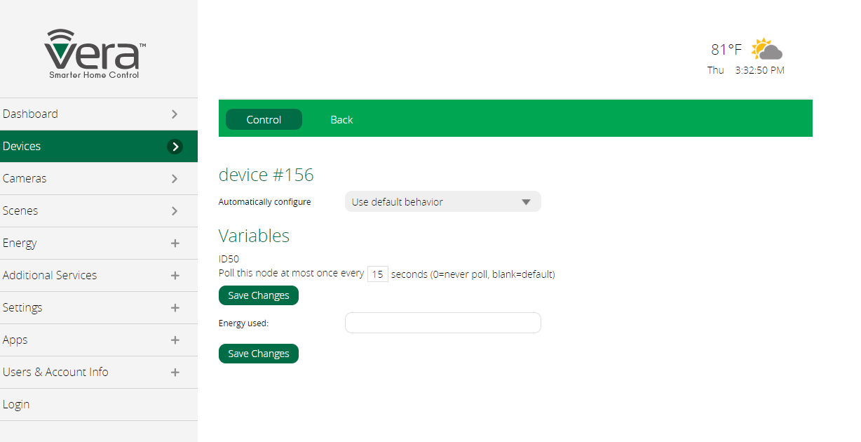

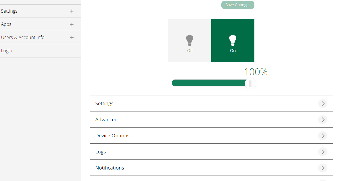

  1. Click on the arrow icon next to the main device in your device list (not on one of the channel devices that start with a "_").
  2. Next, click on "Settings".
  3. Under the "Variables" heading, there is an option to "Poll this node". Set this to a reasonable number such as 15 and hit "Save Changes".
