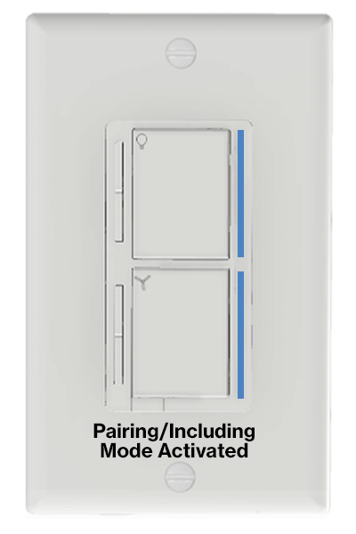

  7. On your Inovelli switch, hold down on the top of the light config button (Button A - Figure 1.1) and press the light button (Button B - Figure 1.1) 3x until both LED's pulse blue (as shown below)
  8. You may have to scan the QR Code again to complete the S2 Pairing
  9. If successful, your Inovelli switch LED Bar (B) will turn GREEN (if unsuccessful, the LED Bar will turn RED)
