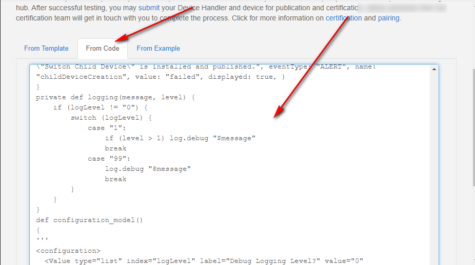

  3. Now you will click on the "From Code" tab and paste the text that is in your clipboard with Ctrl + V (or right click and "paste").

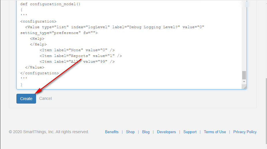

  4. Then, click on the "Create" button to create the device handler into your account.

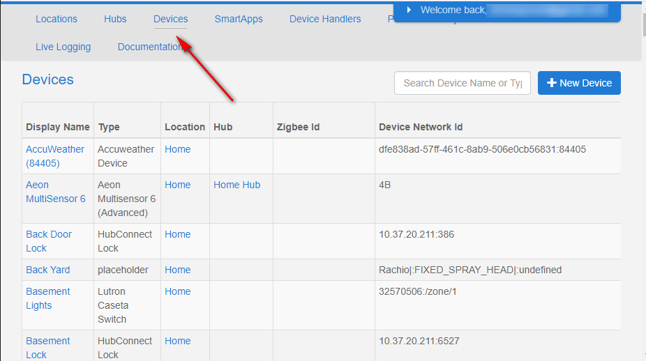

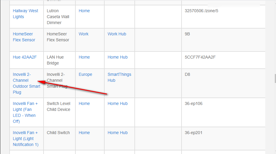

  1. First, click on the "Devices" tab in the SmartThings IDE.
  2. Click on the device that you want to assign the device handler to.

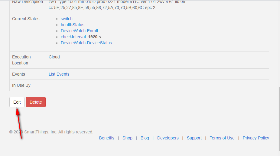

  3. Scroll down to the bottom of the page and click on "Edit".

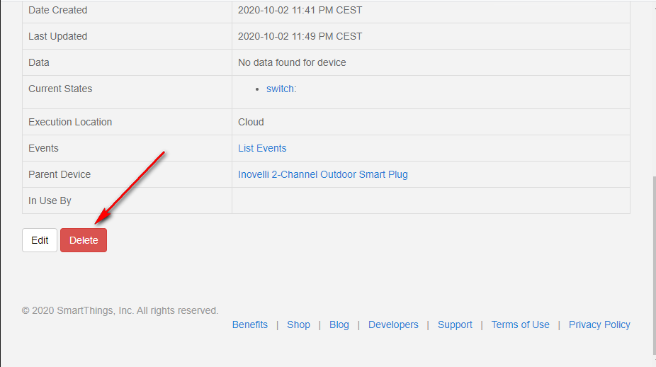

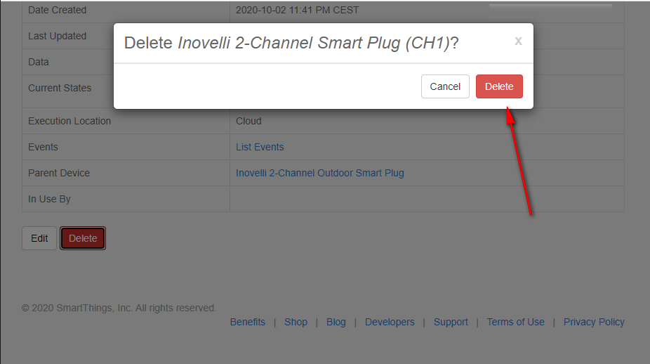

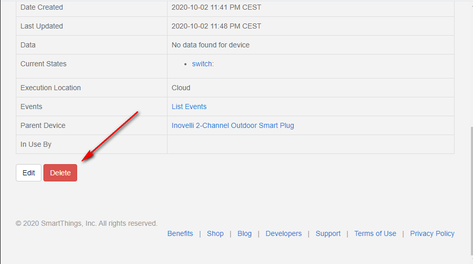

  1. The next step you will scroll down on the device page, select each of the listed "Child Devices", and delete them.
    Don't forget to do this for both of the child devices.

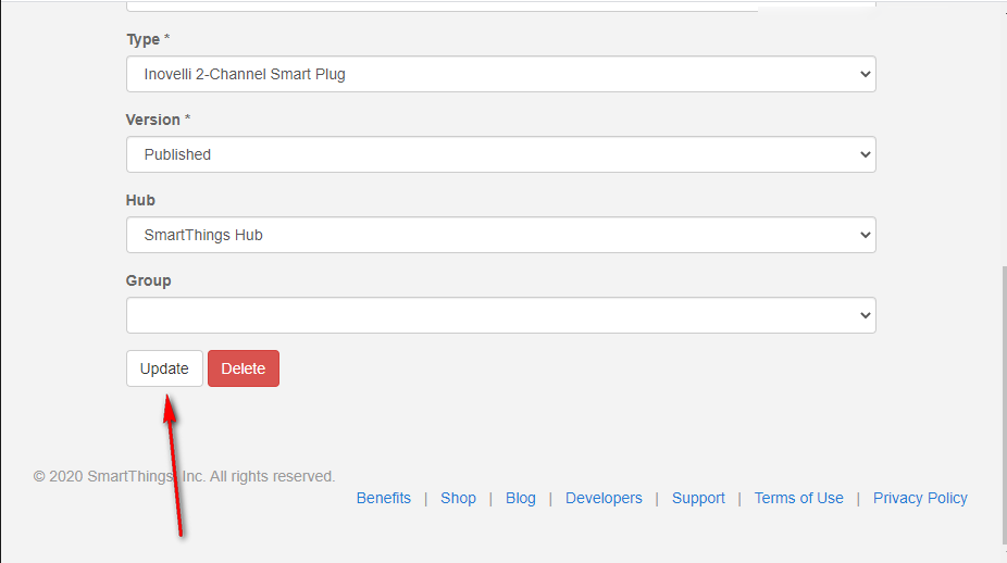

  2. If you scroll down on the device, both child devices should now be gone. Click on Edit to open the settings for the device once again.
  3. In this step you need only to scroll down to the bottom and click "Update". This should create the child devices again.
  4. Scrolling down on the device page should now show that they are back.

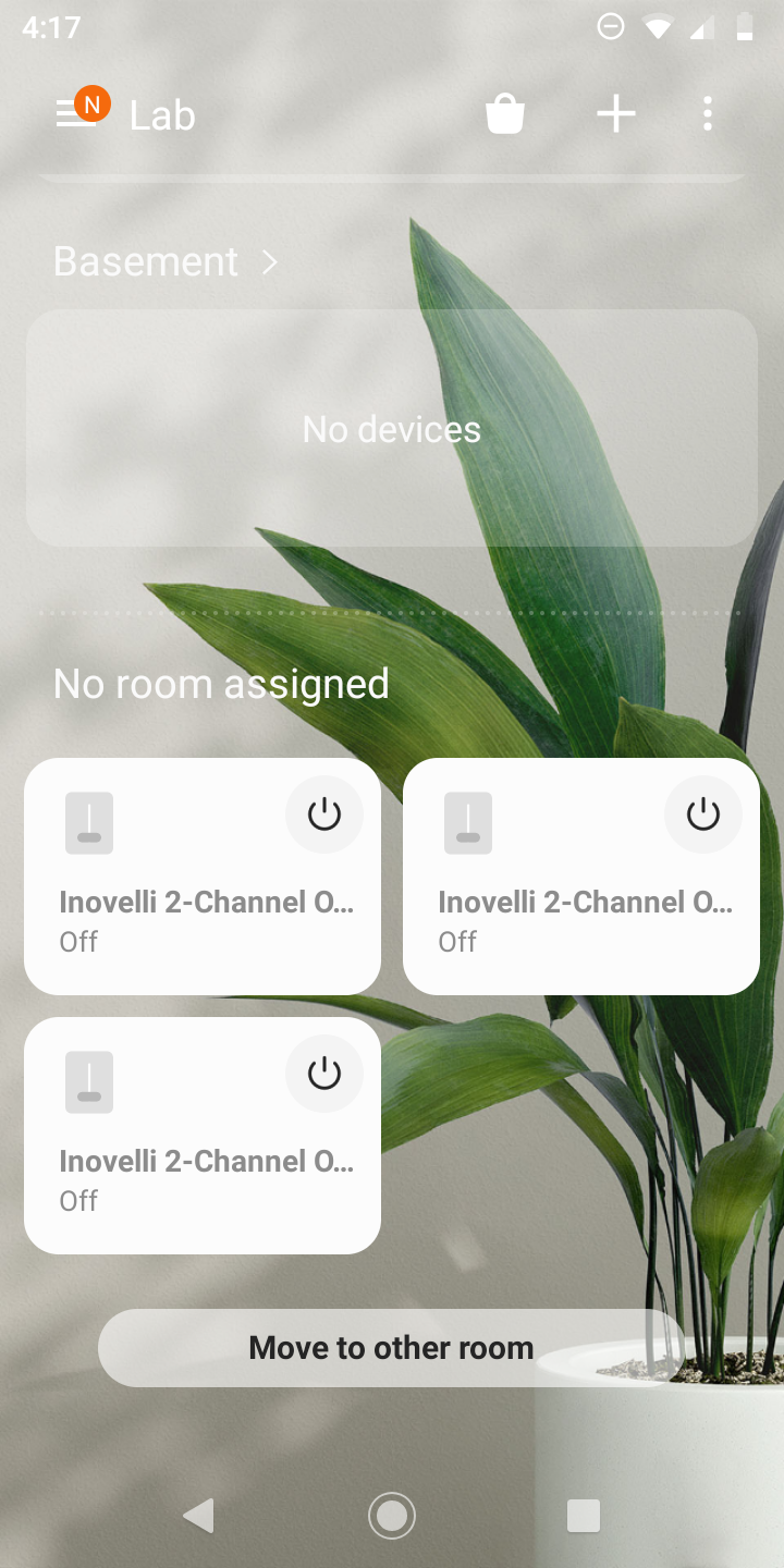

Now, when you go back to the SmartThings app you should see three devices. One should be the main device that controls both channels at once. The other two are the new child devices that can control the individual channels.
