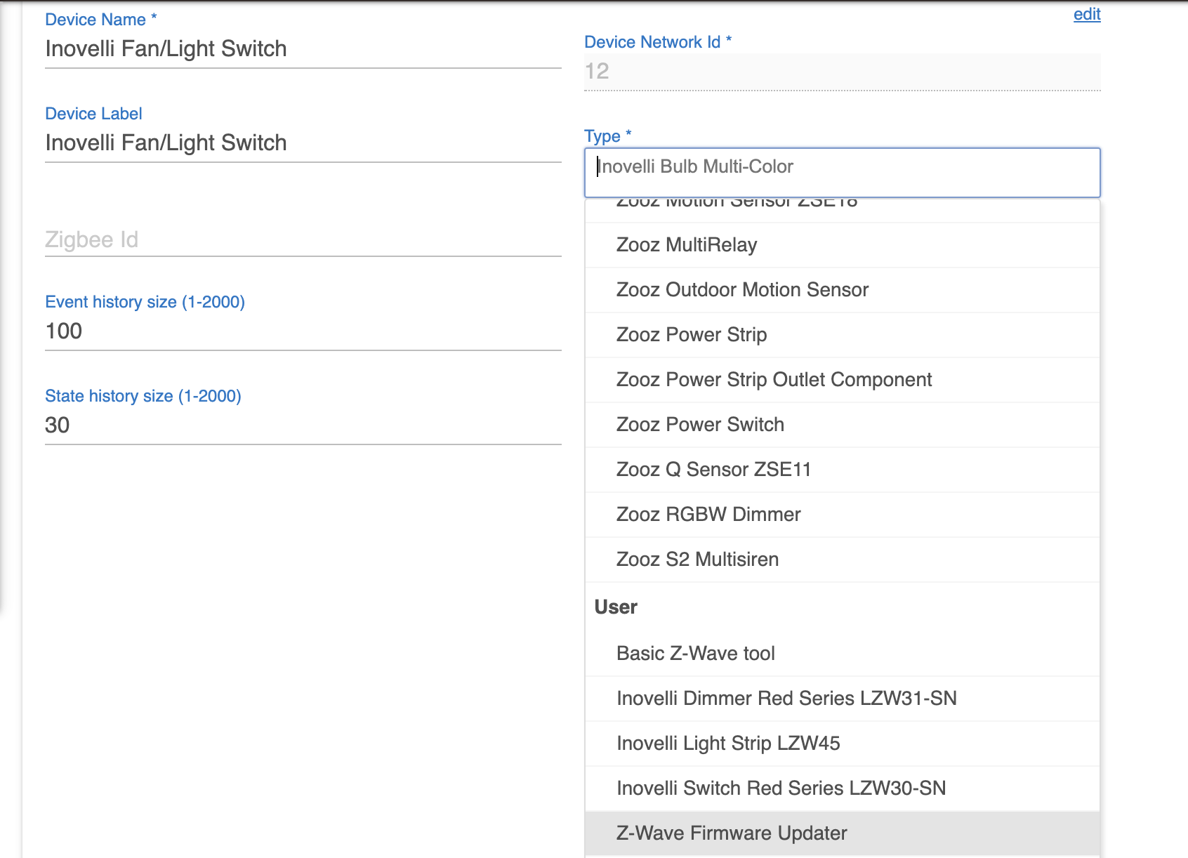

Go to your devices and select your Fan/Light switch, scroll down to the, "Device Information" section and select, "Z-Wave Firmware Updater" -- click, "Save Device".
Now, go to the top and where it says, "Update Firmware" and paste in the URL for the Fan/Light firmware file (should be .gbl)
The target should remain at 0. Now click on, "Update Firmware" and the firmware should start to update. It may take 5-10 minutes. Once you see it get to 100%, it should be done. Once the device has completed updating, change your Device Driver back to your old driver, click Save Device and you are all set! Enjoy your new firmware!
