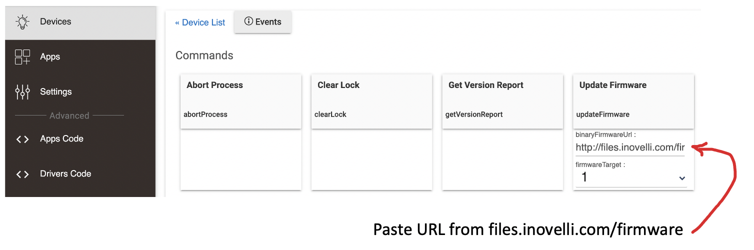

Go to your devices and select your Dimmer switch, scroll down to the, "Device Information" section and select, "Z-Wave Firmware Updater" -- click, "Save Device".
Now, go to the top and where it says, "Update Firmware" and paste in the URL for the first firmware file (should be .otz) and set the Target to 0.
Again, the target should be 0. Now click on, "Update Firmware" and the firmware should start to update. It may take 5-10 minutes. Once you see it get to 100%, it should be done. Now, we'll flash the .bin file.
Click on the .bin file URL from the, "Pre-Requisites" section and grab the hyperlink. Then as you did in the prior step, paste the URL in the, "binaryFirmwareURL" section and set the, "firmwareTarget" to 1. Press, "Update Firmware" and let the device update.
Once completed, scroll down to the, "Device Information" section and click on the, "Type" dropdown and select the proper driver for your dimmer switch. Click, "Save Device" and you should be all set!
