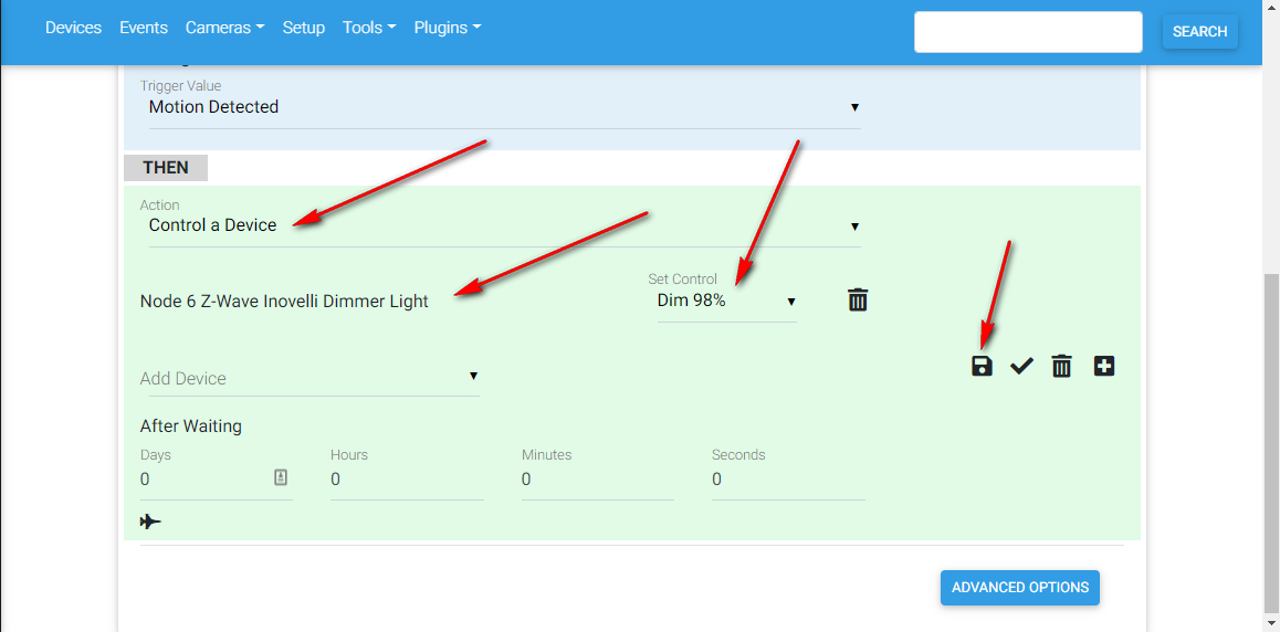

  4. Under the "Then" heading select the following options:
    Action: "Control a Device"
    Inovelli Device - Light
    Inovelli Device - Dim 98%
  5. Click on the "Save" (disk) icons to save all of the configuration of your automation.
  6. Setting up the automation is complete and you can now test it out!

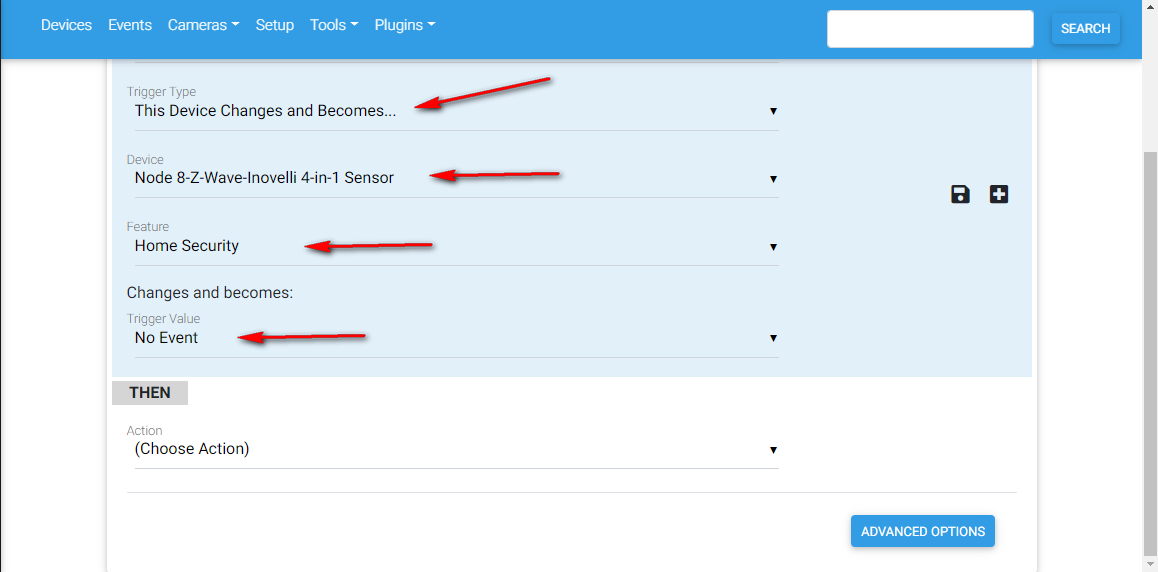

The process is the same as above, but we will be slightly modifying the "trigger" and the "action".
Steps
  1. Create a new Event (shown above) by clicking on the "+" icon and give it the appropriate name. We have chosen "Turn light off when no motion".
  2. In this automation lets set the "Trigger Value" to "No Event".
  3. Lastly we are going to choose the lighting device and set the action to turn it off.
