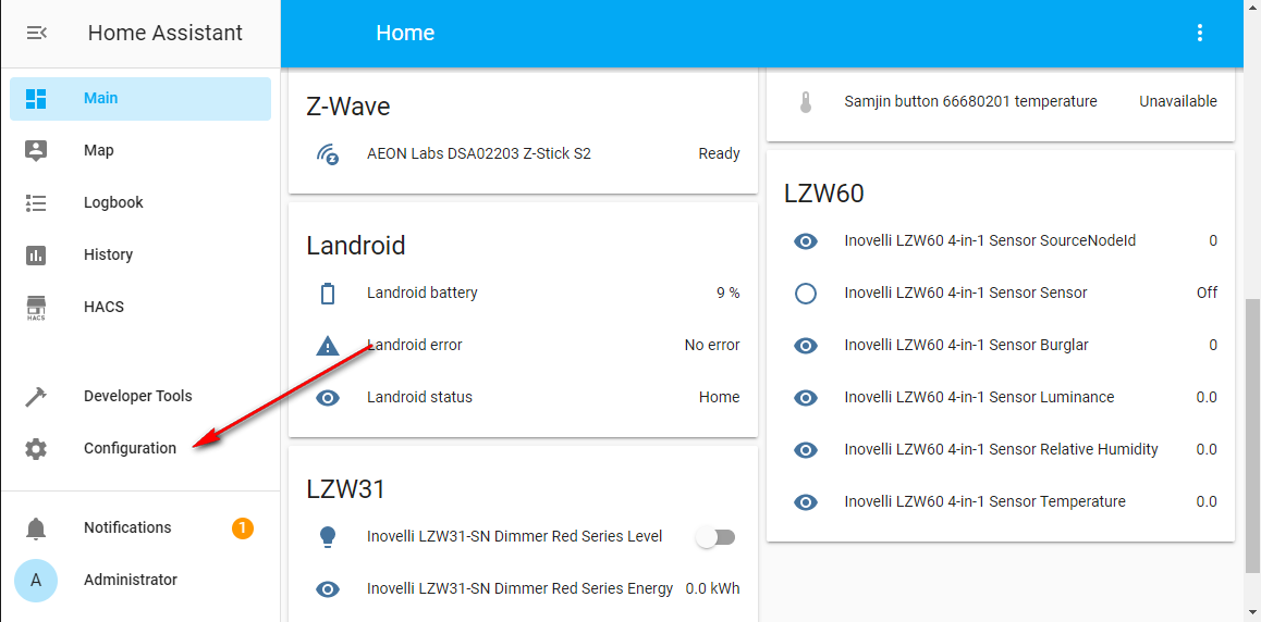

  1. From the Home Assistant web interface click on the "Configuration" link.

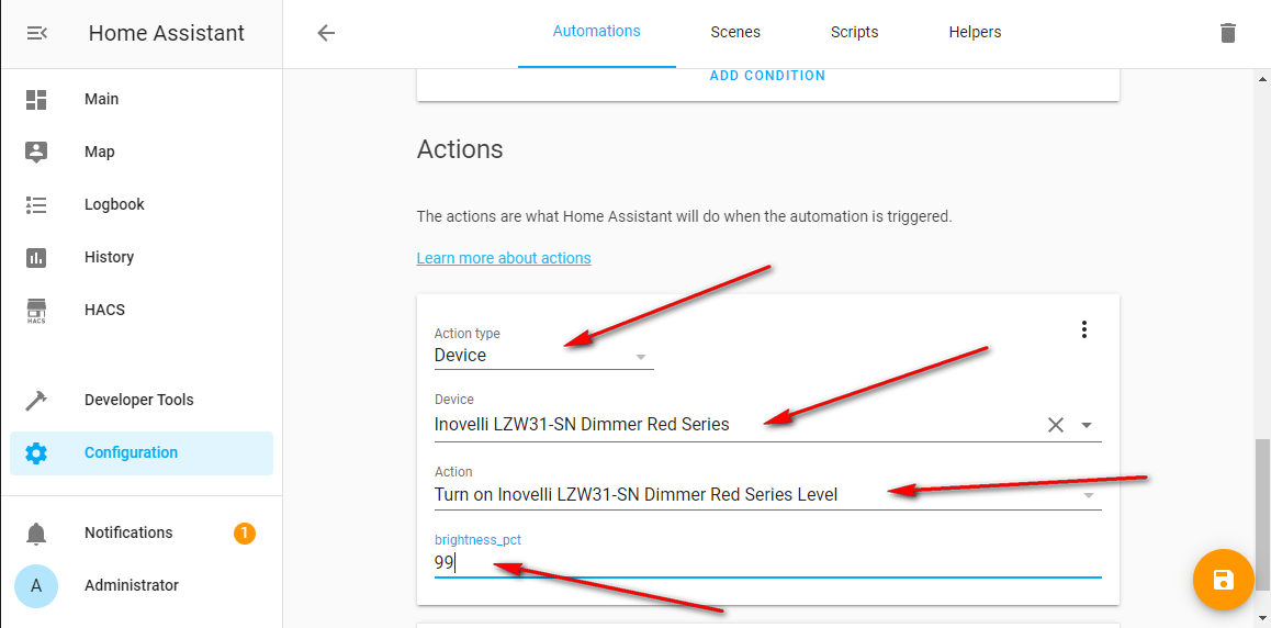

  5. Then, select the lighting device you want to control and the level that you want it to be changed to. In this automation we are controlling an Inovelli Red Series dimmer and settings it's level to 99%.
  6. Lastly, click on the "Save" (disk) icon to save the automation and test it out!

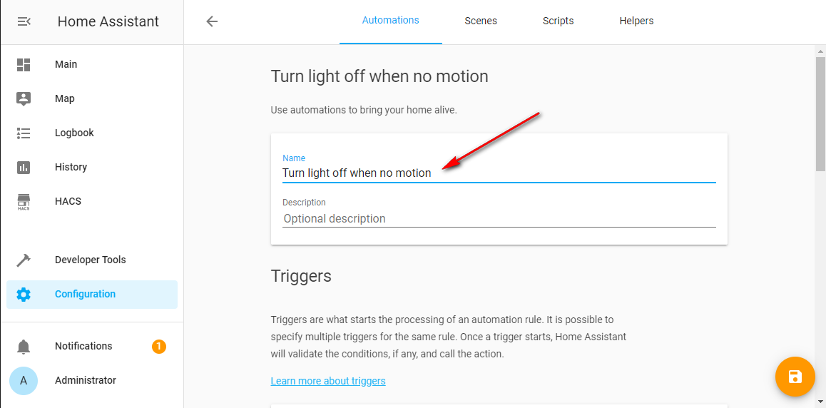

  1. Create a new automation (shown above) and give it the appropriate name. We have chosen "Turn light off when no motion".

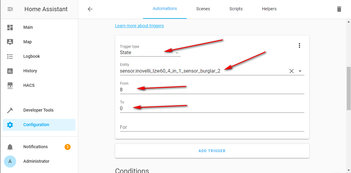

  2. In this automation lets set the trigger to be when the state of the "burglar" entity changes from 8 (motion detected) to 0 (no motion - or idle).

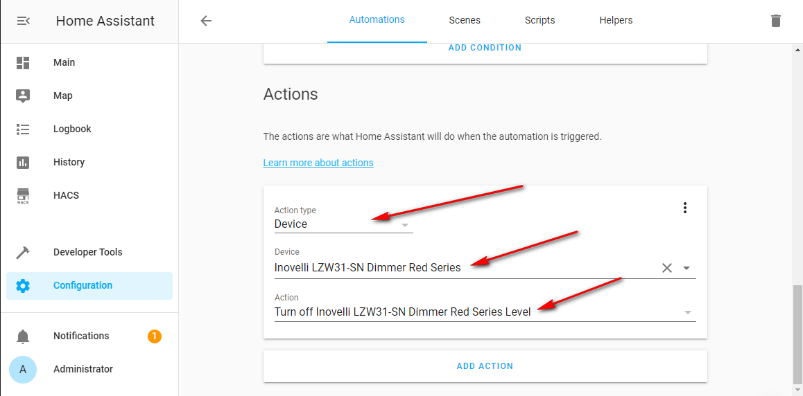

  3. Lastly we are going to choose the lighting device and set the action to turn it off.
  4. Click on the "Save" (disk) icon to finish the setup!
