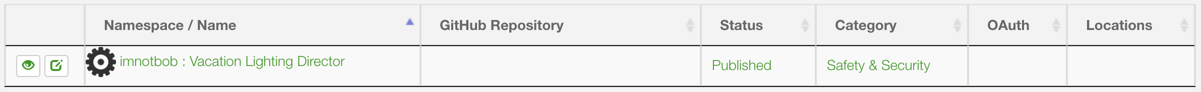

  6. You should now see it show up in your, "My SmartApps" section:
