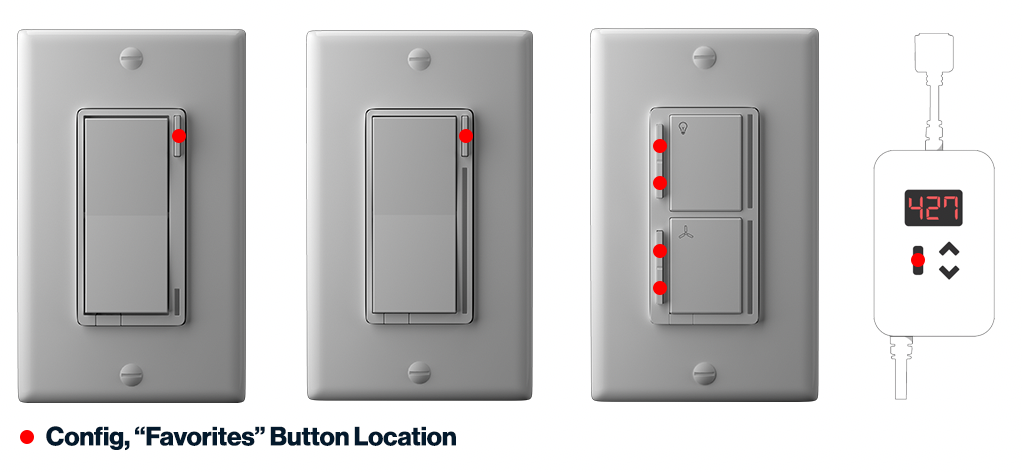

Many times you just want a quick way to reach a certain dim level or you'd like to activate your favorite scene (ie: turn off all lights between the hours of 10pm and 6am). In this tutorial, we'll show you how to turn your configuration button into a, "favorites" button.

Option #1 - Set to Favorite Dim Level
In this example, we'll set the config button to act as a favorite dim level button -- we'll make it so that every time you press the config button, your lights will turn onto 40%. (NOTE: On/Off switch will have to be set to make a dimmer switch or bulb a favorite dim level as the On/Off switch does not dim):

NOTE for Fan/Light Switch: By selecting Button 7 and, "Held" you are selecting the top of the light adjuster config button. Please see the Button Mapping Chart to select the remaining 3 config buttons.
That's it -- now every time you want to let people know dinner is ready, you can triple-tap up on your Inovelli light switch and it will notify everyone with switch heads-up notifications, bulbs and lightstrips turning on.
