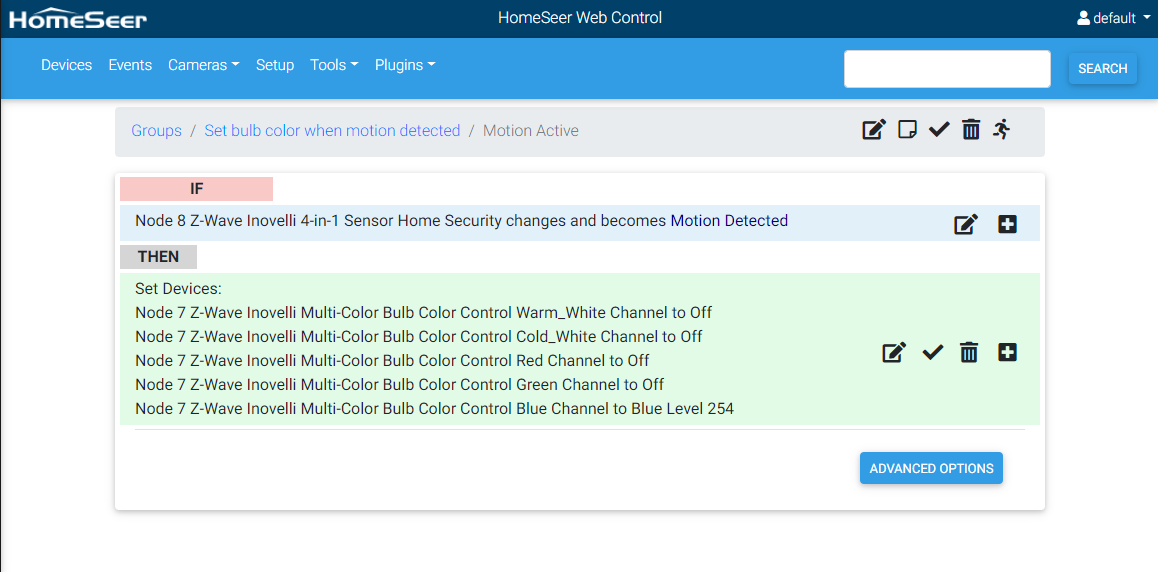

  3. Set the options under the "If" heading as below:
    Trigger: "A Device's Value is . . ."
    Trigger Type: "This Device Changes and Becomes . . . "
    Device: "Node 8-Z-Wave-Inovelli 4-in-1 Sensor"
    Feature: "Home Security"
    Changes and becomes:
    Trigger Value: "Motion Detected"
  4. Under the "Then" heading select the following options:
    Z-Wave RGBW devices usually have a priority of which colors will display when all of them are on. In the screen below you will see that we are turning off all of the channels that we aren't using. This is necessary because of the priority mentioned. For the Inovelli Multi-White bulb the priority from highest to lowest is (Warm_White, Cold_White, Red-Green-Blue).
    Action: "Control a Device"
    Inovelli Device - Warm_White Channel - Off
    Inovelli Device - Cold_White Channel - Off
    Inovelli Device - Red Channel - Off
    Inovelli Device - Green Channel - Off
    Inovelli Device - Blue Channel - Level 254
  5. Click on the "Save" (disk) icons to save all of the configuration of your automation.
  6. Setting up the automation is complete and you can now test it out!
