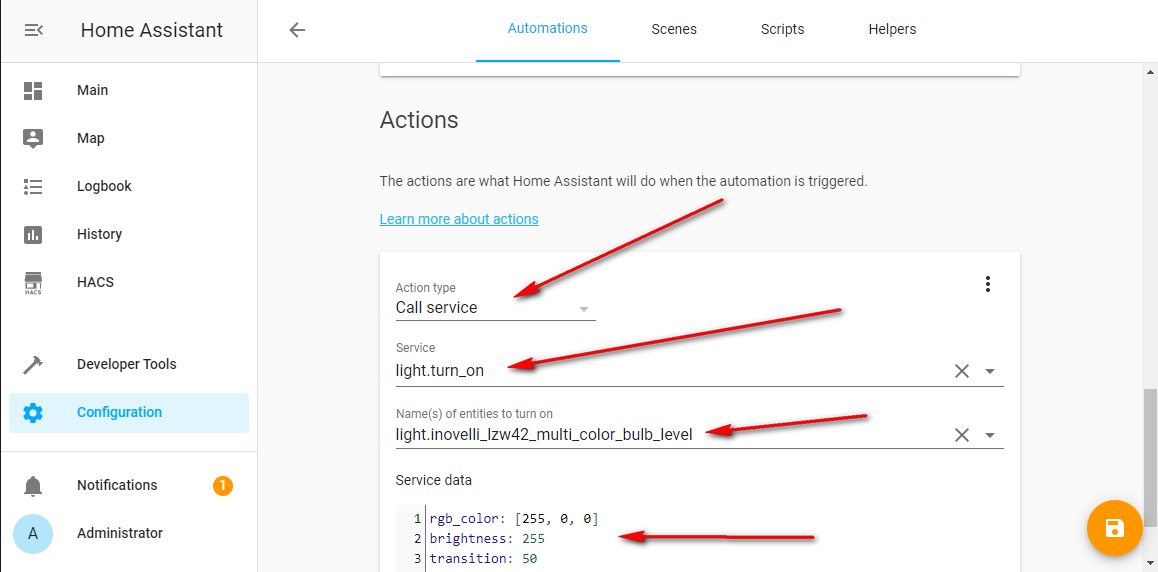

  5. Then, select the bulb you want to control and the color that you want it to be changed to. In this automation we are controlling an Inovelli multi-color bulb's color and settings it's level to 99%.
  6. Lastly, click on the "Save" (disk) icon to save the automation and test it out!

  9.   condition: []
  10.   action:
  11.   - data:
  12.       brightness: 255
  13.       rgb_color:
  14.       - 255
  15.       - 0
  16.       - 0
  17.       transition: 50
  18.     entity_id: light.inovelli_lzw42_multi_color_bulb_level
  19.     service: light.turn_on
