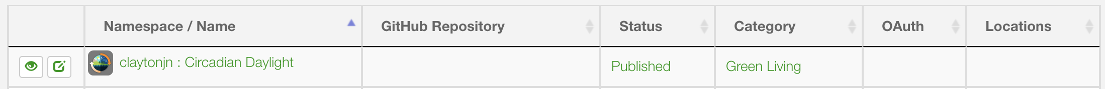

  5. Go back to IDE and in the, "From Code" part, paste the code from GitHub (located in the link above) and click, "Create" and then, "Save" (Do not publish)
  6. You should now see it show up in your, "My SmartApps" section:

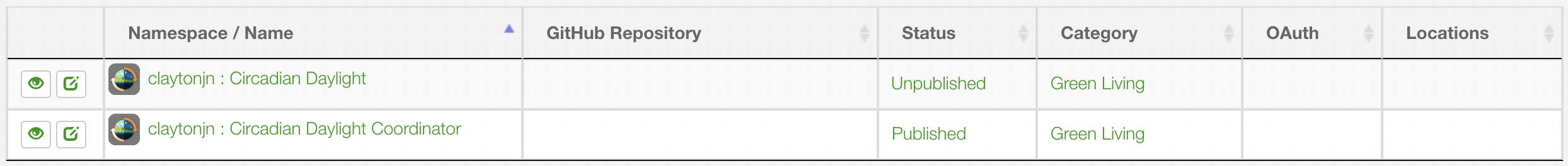

  10. Go back to IDE and in the, "From Code" part, paste the code from GitHub (located in the link above) and click, "Create" and then, "Save"
  11. Then click, "Publish" and, "For Me"
  12. You should now see it show up in your, "My SmartApps" section under the Circadian Daylight SmartApp:
