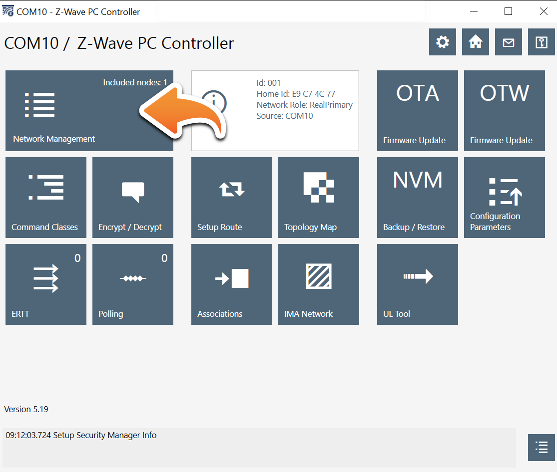

Open the Z-Wave PC Controller 5 Software
Click on “Network Management”

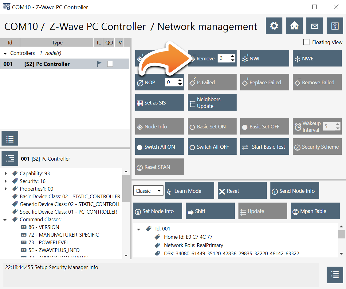

Click “Remove” to remove the Inovelli device from it’s current Z-Wave Network. Follow the exclusion instructions for the device. For example, the NZW30/NZW31 has you tap the top button 6x quickly. The Z-Wave PC Controller software will report that the process was successful.
Click the “Add” button to add the Inovelli device into the PC Controller’s network. Follow the directions to include the device from the manual. For example, the NZW30/NZW31 has you tap the top button 6x quickly. The Z-Wave PC Controller Software will confirm that the process was successful.
