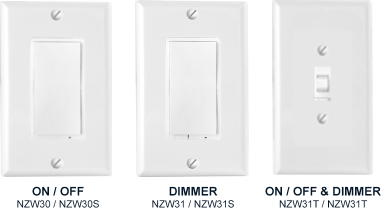

These procedures will work with the above Gen 1 switches (NOTE: all of them).
