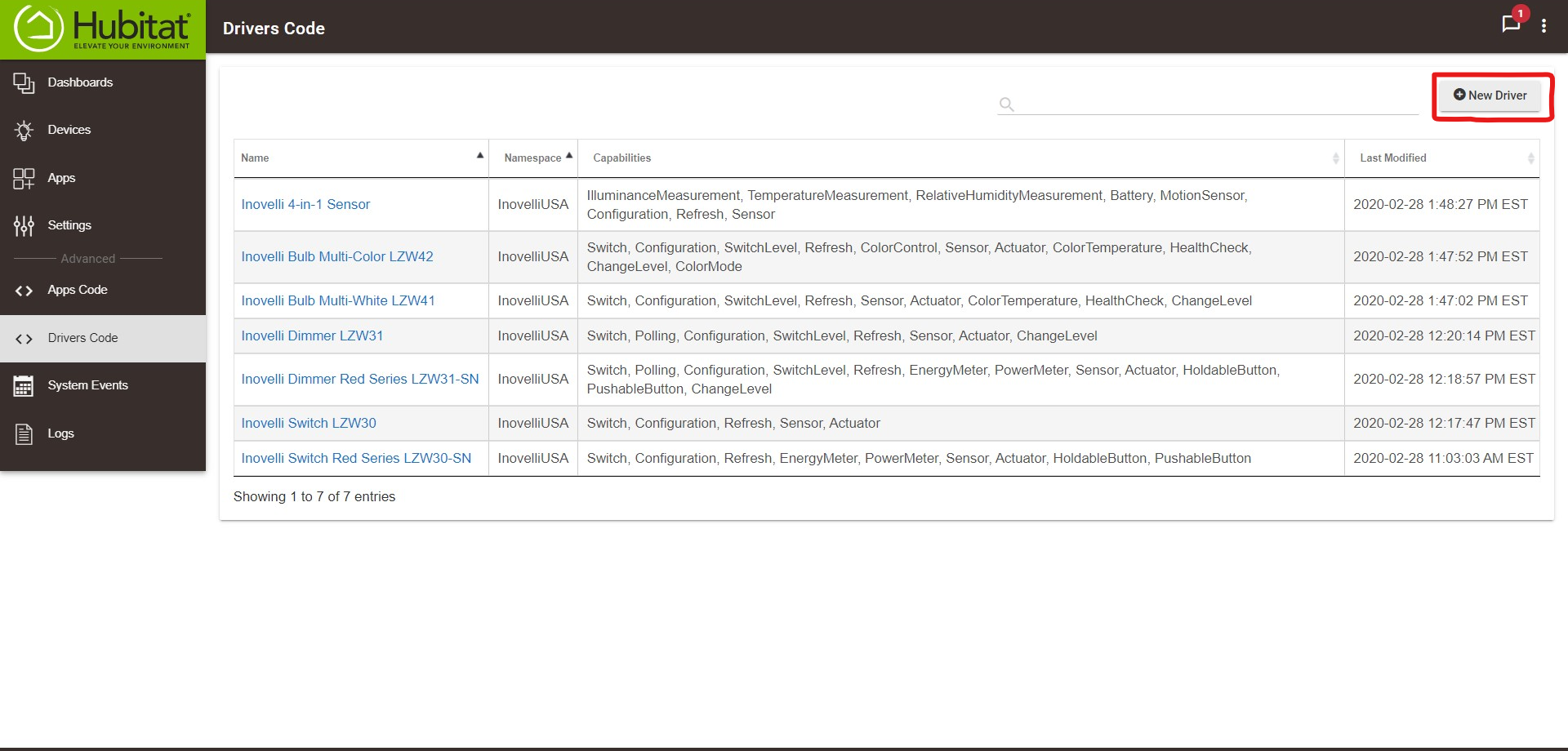

In your Hubitat Elevation, navigate to the Drivers Code Section.
Step 2
Click on New Driver.

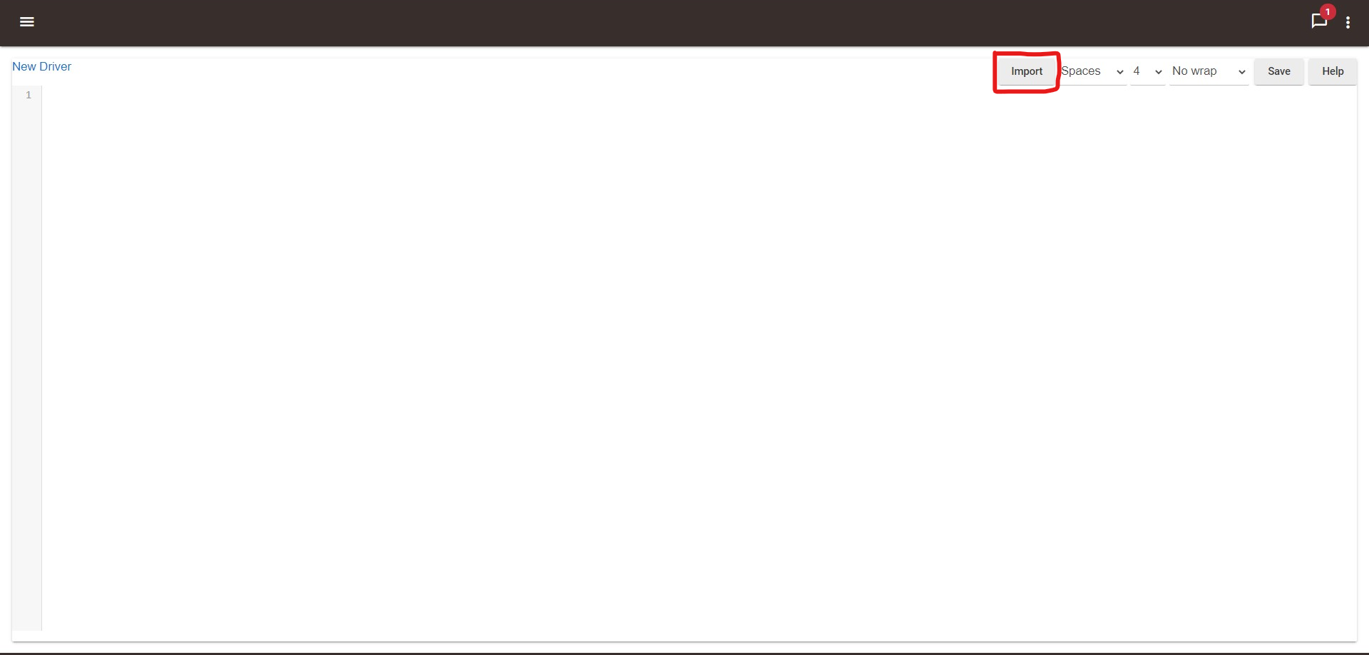

Step 3
Click Import.
Step 4
Paste the Z-Wave Firmware Updater Tool URL (up above in the "Things you will need" section) in the box and click Import.  It will ask if you want to override the current code.  Click ok.

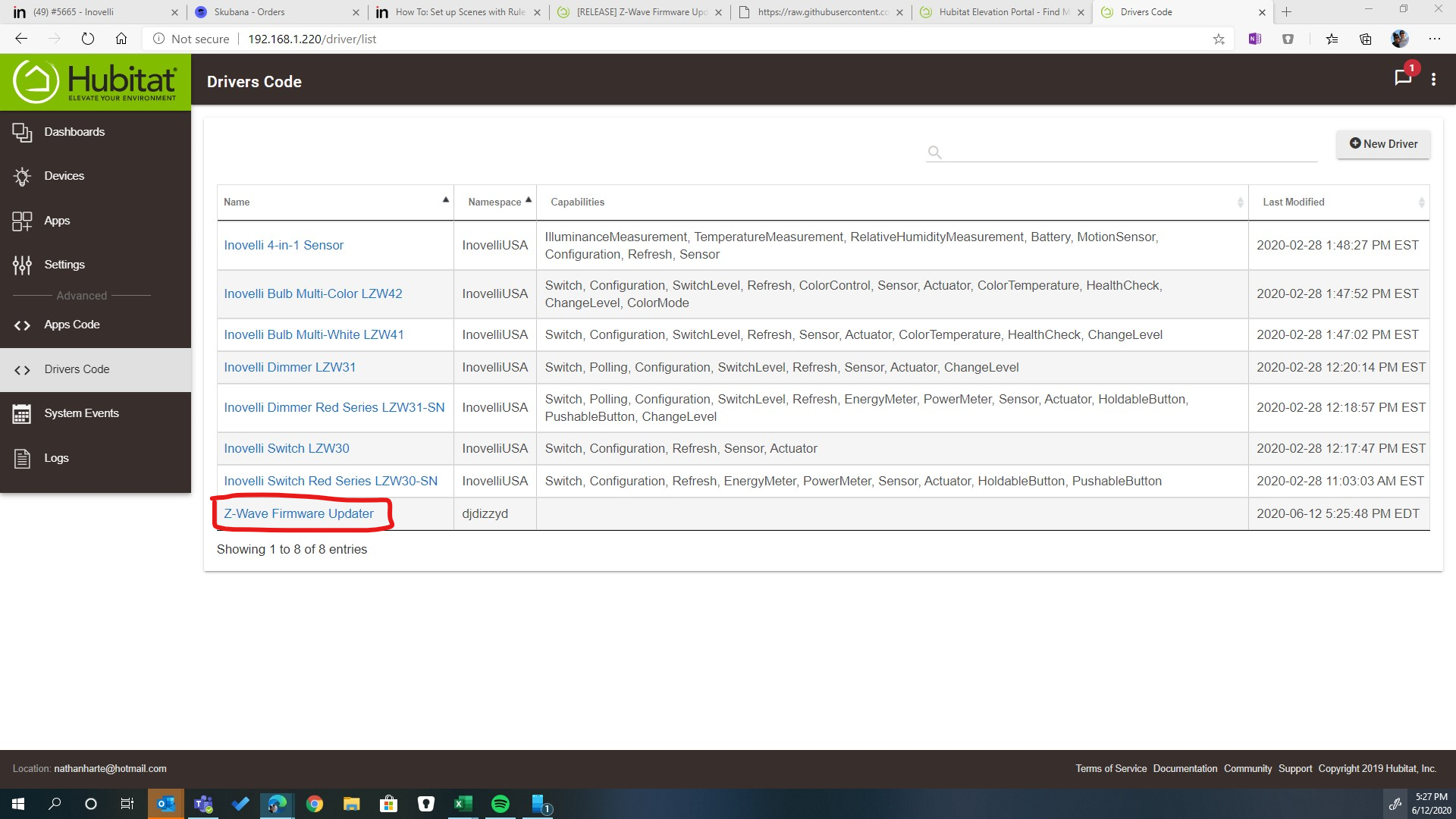

Navigate back to your Drivers Code page and you will see the new driver listed.  (Probably at the bottom of the list since it starts with Z.)

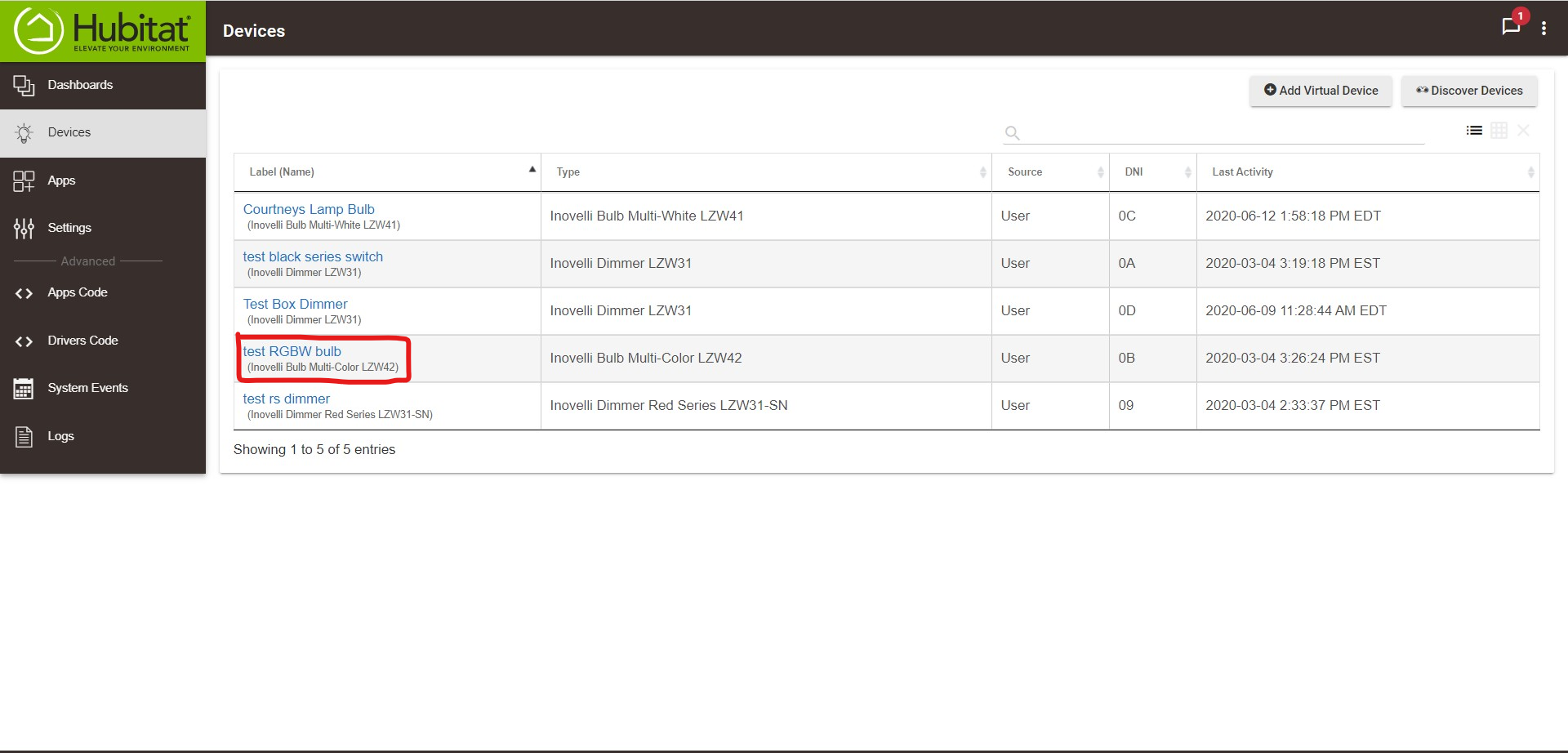

Go to your list of devices and find the device you want to update the firmware for.  In this example we will use an Ilumin RGBW bulb.
