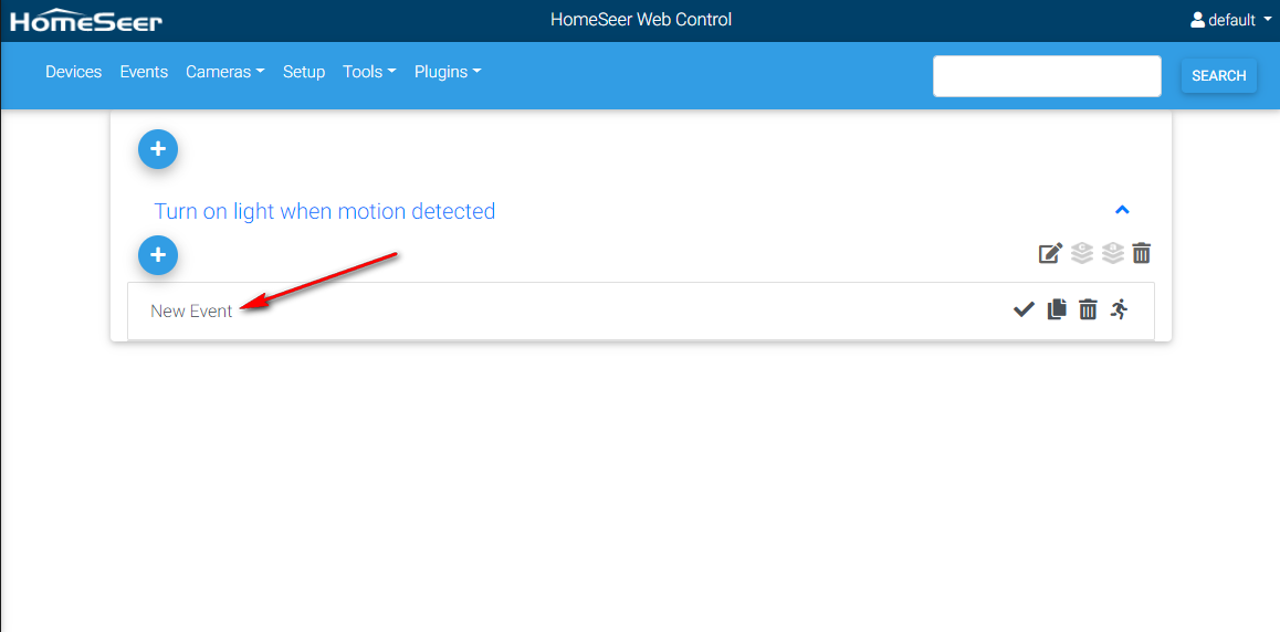

  1. From the Homeseer web interface click on the "Events" link.

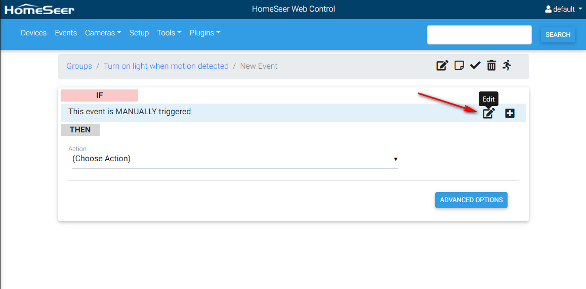

  2. Click the "+" button, then click on the "New Event" link, and then the "Edit" icon..
