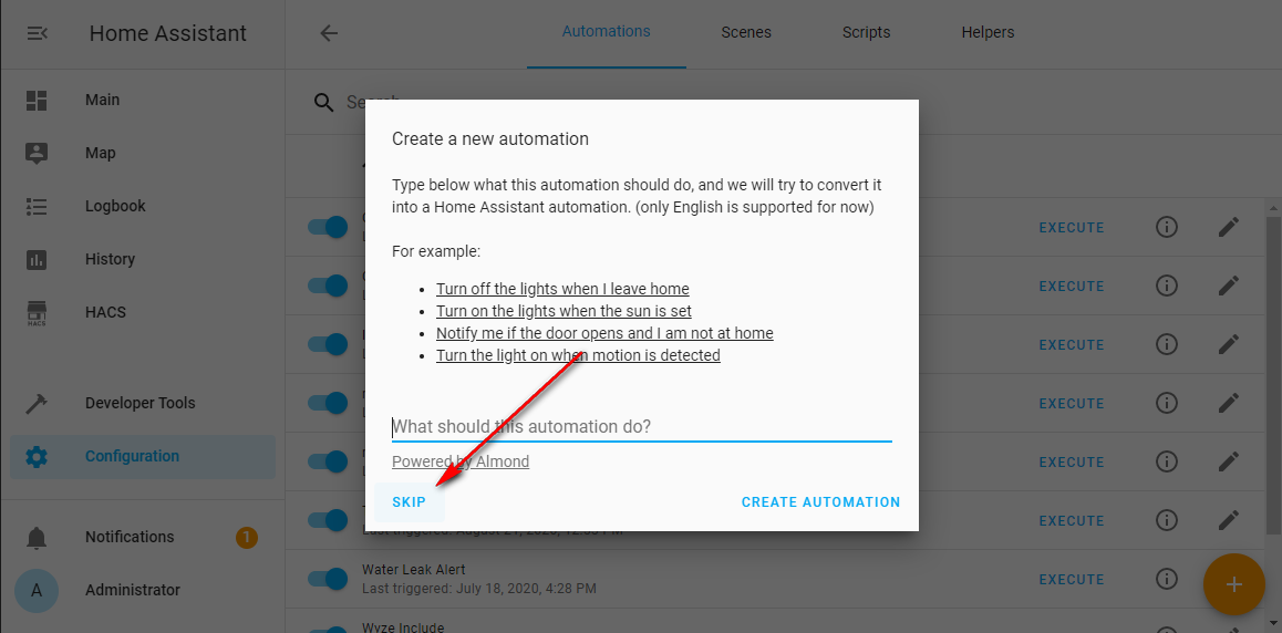

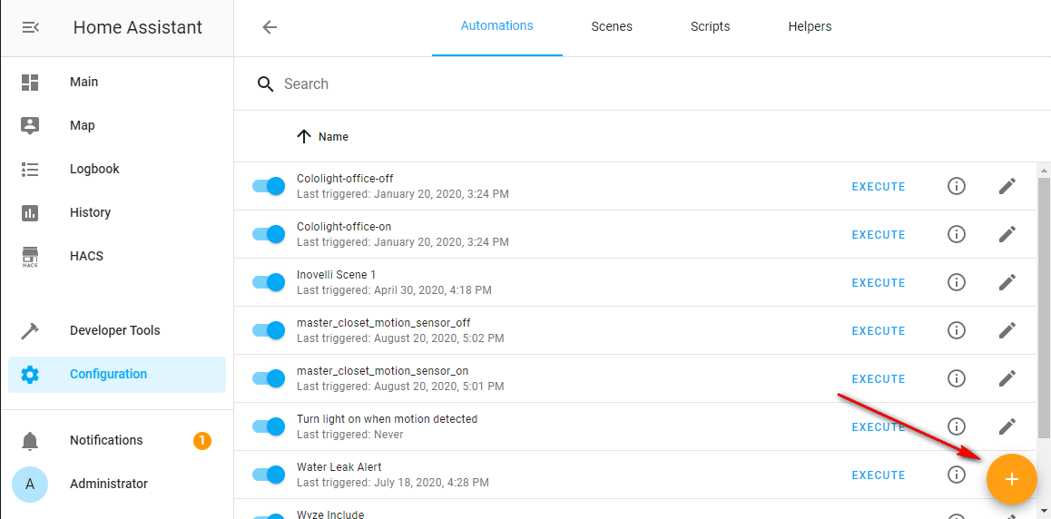

  2. Click "Automations", then the "+" button, and then click on "Skip". We will be setting the automation up manually so there is no need to use the wizard.

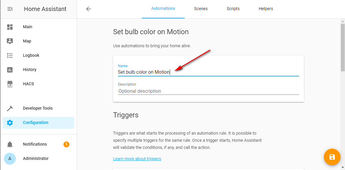

  3. Input a name for your automation. We have chosen "Someone is at the door".

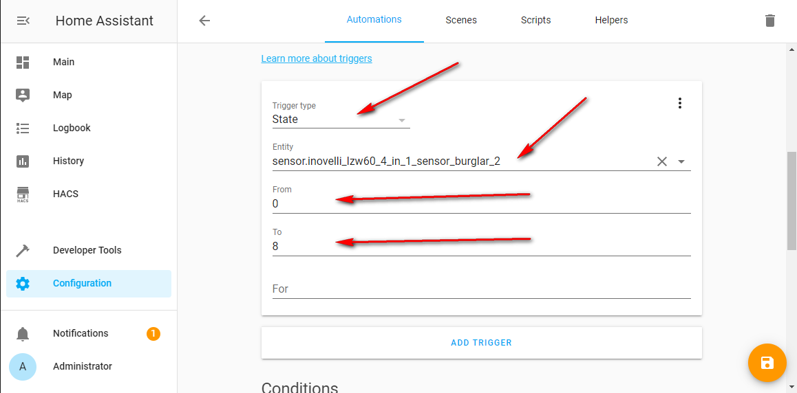

  4. Next, choose "State" and specify the Inovelli 4-in-1 entity with the appropriate data. When the motion sensor is tripped on the device it reports a state of "8" to it's "burglar" entity. This is because in z-wave, that sensor has many available state options. 8 means that motion was detected in an unknown location. So, we are having this automation trigger when the motion sensor burglar state changes from 0 (no motion - or idle) to 8 (motion detected).

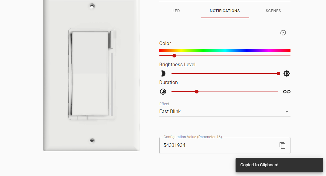

  5. Now we need to calculate the parameter value for the color, effect, level, and duration that we would like to see on the device. The easiest way to do this is to use an online calculator that one of our community members created. It can be found right here: http://calculator.inovelli.com/
  6. In the calculator change the "Switch Type" to the device you are using. Here we are using the Fan + Light. Next, choose the notification color, brightness level, duration, and effect. Here we are going to select choose for the LED strip to fast blink orange at full brightness for 1 minute. The number that the calculator outputs is 54331934.

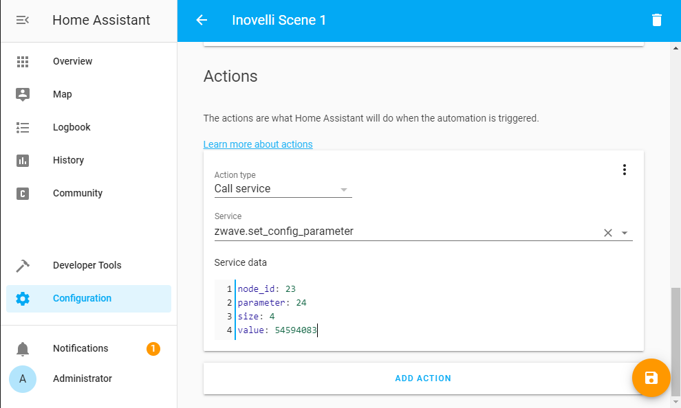

  7. Next, in the Actions section, I have chosen to call the service "zwave.set_config_parameter". This action will turn on the notification of the first LED bar. You can of course choose whatever you would like here, but I have chosen something simple to demonstrate. If you are wanting to do something like "control Philips Hue Lights" then you would have something different for the Actions section of this automation. Here is the data to put into Home Assistant. Notice that we are taking the output from the notification calculator and putting it into the value section for the action.
    node_id: 23
    parameter: 24
    value: 54331934
