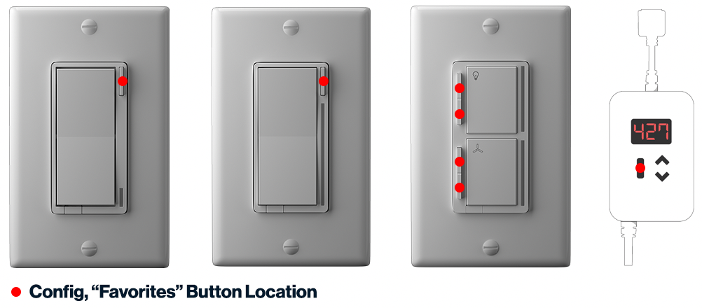

As mentioned in Step 1, there are two different scene definitions (SmartThings and Z-Wave). In Step 2, we'll create a Z-Wave scene that will run your SmartThings scene when you tap the config/favorites button once. Finally, we'll take it a step further and only allow this button press to work during the hours of 10pm and 6am so you don't accidentally run the bedtime scene during the day. To recap, here's what we're going to setup:
  1. Press the config/favorites button (see below) and it will activate your SmartThings scene created in Step 1
  2. This Z-Wave scene will only activate the SmartThings scene during the hours of 10pm to 6am as to eliminate accidental triggers during the day

NOTE for Fan/Light Switch: By selecting Button 7 and, "Held" you are selecting the top of the light adjuster config button. Please see the Button Mapping Chart to select the remaining 3 config buttons.
