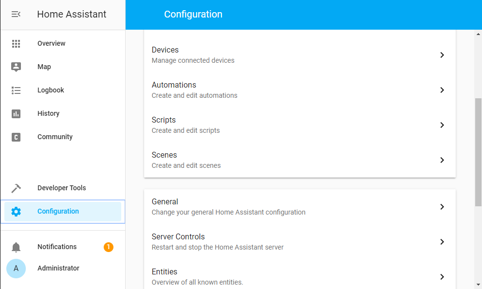

1. Click on "Configuration" from the Home Assistant web GUI main page.
2. Next click on the "Automations" link to create an automation.

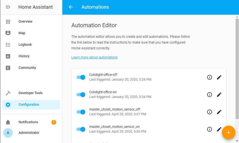

3. Now you can click on the + icon to create a new automation.
4. Name your automation whatever you would like and proceed to fill in the "Triggers" and "Action" sections.

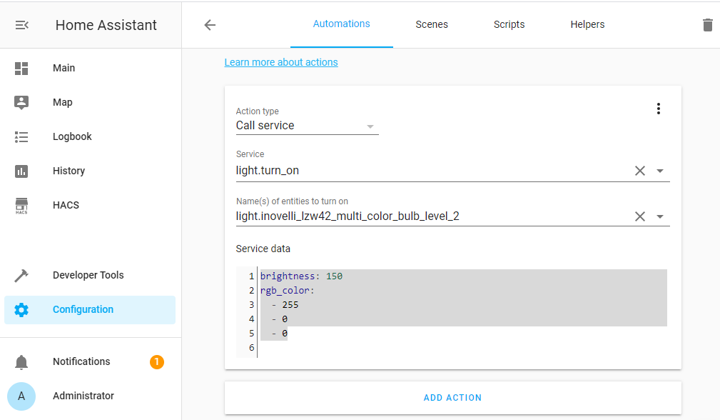

6. Next, in the Actions section, I have chosen to call the service "light.turn_on". This action will turn on the bulb and set its color to red. You can of course choose whatever you would like here, but I have chosen something simple to demonstrate. Select the correct entity from the drop down list and input the following service data. You can change this to specify a specific color or brightness that you would like to use.
brightness: 150
rgb_color:
  - 255
  - 0
  - 0
