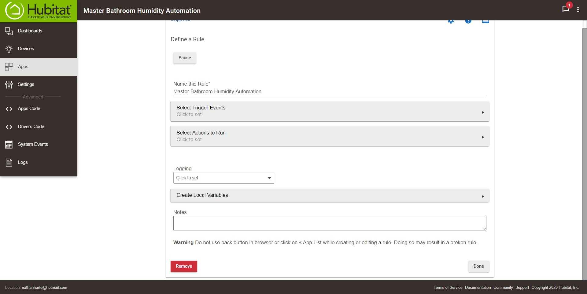

Once you are in your Hubitat Home page go to Apps > Rule Machine > Create New Rule.  Give it a name.  We are going to call it "Master Bathroom Humidity Automation".  (I also call this the don't fog my mirrors automation.)  It should look like this at this point.

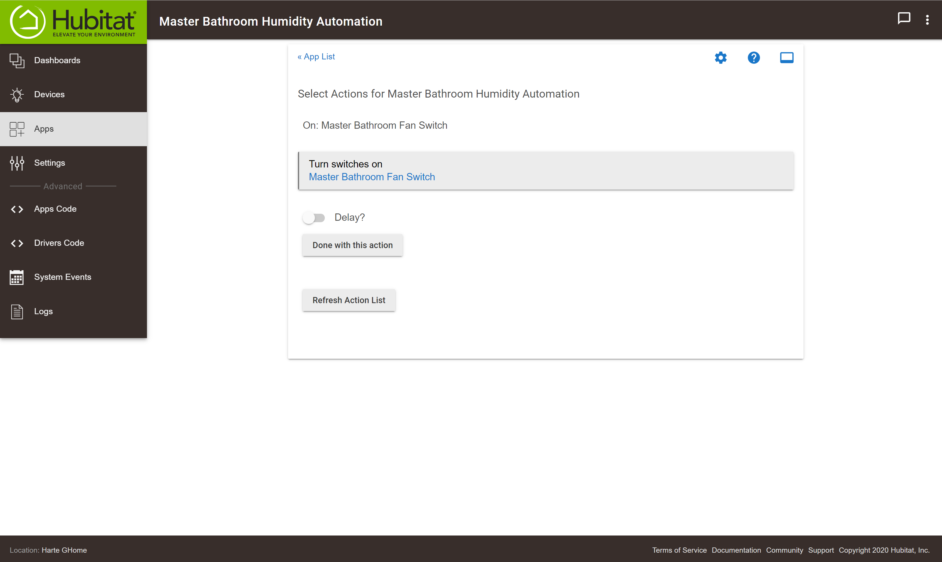

Now that the trigger is complete, lets create the action.  Click on "Select Actions to Run".  In the drop down, select "Control Switches, Push Buttons".  Select Toggle switches on.  Select the switch you want to use (hopefully its the one that controls your bathroom fan) and then click Done with this Action.  It should look like this below.
